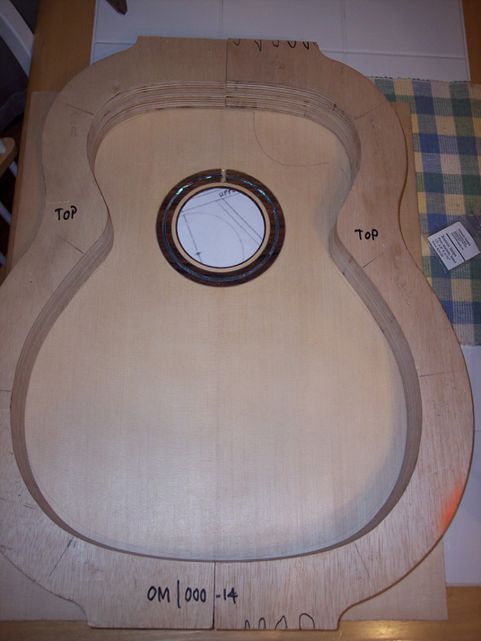

I have plans on the way but I was wondering if anyone here could let me know the soundhole diameter on the OLF OM. See I thought I was going to wing the size/shape/bracing pattern with this first build, but I decided to go with something more tried-and-true. I already did the rosette and cut out the soundhole, so I am hoping that mine will match up to that.

Ok, lets just hypothetically say that my soundhole ID is 3.7 or so (without the soundhole binding it would be more like 3.9) .... is this going to make a big difference in the sound/volume?? Aesthetically it looks fine... I think anyway.

A smaller soundhole will make a difference, but whether or not you will actually notice it is questionable. There will definitely be a little less volume. Yours is so close to the 4" required that I dont think I would sweat it if it were me.

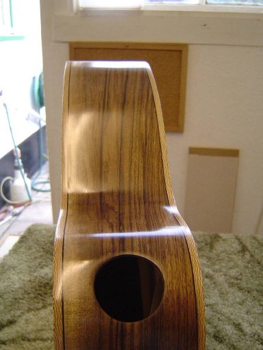

Yours at 3.7" is on the face of it only 0.3" smaller. However this is a larger proportion of the area than the 0.3 would seem at first sight, as this is taken from the outside edge so would represent the difference in area of a circle 3.7" and 4". The difference is more than 1.8sq" or nearly 20% bigger. that is not inconsiderable.
My solution would be to add a soundport in the upper bout, this is easily done and will offset any reduction in soundhole size (they add a great quality to the perceived sound anyway.)
Something like this:

The general "rule of thumb" is that a smaller soundhole favors the bass, and a larger soundhole favors the treble. If you add a side port, it's likely to favor the treble in either case. Alan Carruth could tell you why.

Thanks for the suggestions, now I have some options to weigh before making a decision. I like the soundport idea because I already had some visions of doing this. I am not sure if I will scrap the binding yet to open it up... I think it looks purdy

You can cut a soundport at any time during the construction. Some cut them before bending some, after bending when the sides have had the head and tail blocks glued in place. I do mine after the back is on but before the top.
That said I have successfully added a soundport as a retro-fit to some of my guitars, no need to take them apart.
